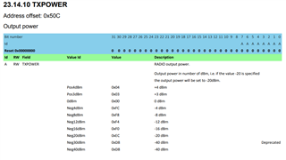

Can configure nRF52832 TX power as -24dBm, rather then -20 dBm and -30dBm?
Thanks
Thanks
No, only the values in the NRF_RADIO->TXPOWER register are valid options. Any numbers not in this (such as -24 dBm) results in -40 dBm output power.
Andreas
Andreas
