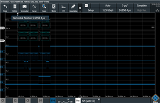

I can initialize the flash, no problem, read it's device ID fine. When I write to the qspi, it will write as expected according to the analyzer, return an error of 0, then lock up at the while(!m_qspi_finished); If I remove that, I get error 17, which is BUSY.
