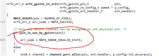

However, when running the program, it terminates in the nrf_drv_gpiote_in_init(PIN_IN, &in_config, in_pin_handler);, telling that the pin is in use by gpiote.
I have also tried using pin 43, with the same result.
What am I missing/doing wrong?

    You get the error because you are trying to configure the same pin twice.
    The Board Support Package (BSP) is a higher level library that configures GPIO pins for buttons and LED'S. It also handle things like debouncing buttons an mapping them to events, and signalling various states with LED's blinking etc. Since this use GPIO pins it will conflict if you try to use the same pin for another purpose. If you want to test GPIO interrupts from the pin_change_int example within an example that use BSP, the simplest is to use a pin which is not associated with a button or LED, as this will then not conflict with BSP.
    Regarding the BSP_INIT_LEDS and BSP_INIT_BUTTONS, you can see that these are bit wise OR'ed as flags when you call bsp_init(). So if you for instance only want to configure LEDs but not buttons, then you modify the call to be like this (and vise versa if you only want buttons):
    err_code = bsp_init(BSP_INIT_LEDS | BSP_INIT_BUTTONS, bsp_event_handler);
