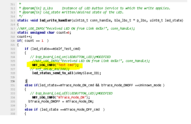

    Peripheral(All) side code that has been added as below
    Functionality is, led_write_handler event will be triggered  when the
    API ble_lbs_led_status_send() sends the predefined data to the all peripherals from Central side.
    and  the received data (led_state) will be compared with mSelf_Test_cmd (variable ) then
    i am sending the particular predefined data(which is called slaveID) to Central by using the API
    led_status_send_to_all().

    • I will explain how i came know  that peripherals were not received from central.
    Peripheral side:
    I am printing the string "Test cmd" before sending the slaveIDs to Central and it did not happen (monitoring in terminal)
    Note : u8myslave_ID will be different to each one of the peripheral code so that we will come to know different Slaves (peripherals) in central side.
