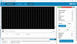

Then, run LTE Link Monitor of nRF Connect
Look like it DID NOT work with 9600 bps baud?

    The LTE Link Monitor has a fixed baud rate of 115200, from what I understand.

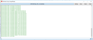

  • Hello again,
    I was able to configure the Secure Boot to use baud rate 9600. See screenshot from Termite:
    Be aware that this only applies for Secure Boot, but the application itself will still have baud rate 115200 as can be seen in the bottom of the screenshot.
    Øyvind

    Ja, the problem is nRF Connect LTE Link Monitor has 115200 bps baud, NOT autobaud. But, I am confusing why my Termite terminated automatically after 4-5s. But it may be my computer problem.
