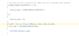

    Thank you for clear answer. Following the link you tagged, I found this, which seems to be a part of sending data via ble.
    But the yellow boxed line is like sending as string and I have no idea where can I use sprintf() there.
    Or you mean I should add another line above that yellow boxed line, like value = sprintf(value)?
    And one more question is I want to figure out the meaning of the numbers, I can check with uart terminal. There are 4 samples at every event, but the number is very random in the range from about 10 to 1000. I didn't give any voltage inputs yet, so I think the value should be about 0. at least some constant value. Could u help me with this too?
    The function name is misleading - it sends raw bytes - not a "string" in the 'C' sense.
    That's a standard 'C' programming question - nothing specifically to do with Nordic!
    sprintf() is part of the Standard 'C' library:
    http://www.cplusplus.com/reference/cstdio/sprintf/
    You use it to create a string in a buffer that you provide.
    You could then transmit that buffer using ble_nus_string_send().
  • You can do something like this (given that you keep the SAMPLES_IN_BUFFER at 4):
    uint8_t nus_string[20];
    int n = sprintf(nus_string, "%d\r\n%d\r\n%d\r\n%d\r\n", p_event->data.done.p_buffer[0], p_event->data.done.p_buffer[1], p_event->data.done.p_buffer[2], p_event->data.done.p_buffer[3]);
    if(n <= 20)
    	bytes_to_send = n;
    else
    	bytes_to_send = 20;
    err_code = ble_nus_string_send(&m_nus, nus_string, bytes_to_send);
    If you have not connected the inputs, they are floating and you will get varying values in the full range of the SAADC resolution (configured at 10 bit - 0 to 1023 in the example).
