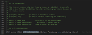

  • Hi.
    Default key 00112233445566778899aabbccddeeff is set inside of OpenThread in the file key_manager.cpp, line 50
    This is the key that is used in the precommissioned examples, it can be changed by using otThreadSetMasterKey:
    But only in the precomissioned examples. It willl be generated when the Thread network is formed and every joining node would obtain it during commissioning.
