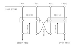

  • This is nice, just implemented something like this myself. So, let me tell you how I did this using PPI, a PORT event and COUNTER.
    First I configured the GPIO to trigger on both a rising and falling edge using:
    nrf_drv_gpiote_in_config_t config = GPIOTE_CONFIG_IN_SENSE_TOGGLE(false);
    To be able to start and stop the counter, at least two PPI channels are to be created with the start-task and the stop-task of the counter respectively connected. However, only the start-channel needs to be enabled initially. When the event occurs, this start-channel needs to be disabled and the stop-channel enabled.
    However, the PPI does not have tasks to enable or disable channels directly. Instead PPI channel groups can be used to enable or disable a PPI channel. Adding the 'start' channel to one channel group and the 'stop' channel to the other now makes it possible to have a channel disable 'itself' by attaching the fork of the channel to the disable task of the channel group.
    The tasks to enable a PPI channel group again I need two additional PPI channels, that are also added to the respective channel groups as illustrated in the final configuration below:
    I hope this gives you inspiration ;-)
