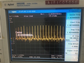

How to speed up the change between PTX and PRX of esb?
I am using 2 esb devices to test my packet send and received.
My use case is:
1. Node-1 and Node-2 is power-in in PRX mode
2. Node-1 switch to PTX and send a packet, then switch to PRX,
3. Node-2 receive packet, switch to PTX mode and send a packet out. After send packet, switch to PRX.
4. Node-1 receive packet, switch to PTX mode and send a packet out. After send packet, switch to PRX.
If the speed between PTX and PRX is to fast, then it will cause many "Send error".  If I add some delay (Ex: use nrf_delay_ms(2)), then there will no error occur.
What is the bottleneck? PTX switch to PRX? or PRX switch to PTX?
Thank you,
Chianglin

  • HI,ovrebekk:
       I just use ESB the example to twoway exchanging data. When when i is tranmitting,It seem to transmit  on many frequency in on channel,as picture below(in channel 3 ):
  • Hi
    What does it look like if you show a larger part of the band?
    I will discuss this tomorrow with one of my more hardware knowledgeable colleagues to get some input on the plot.
    Best regards
    Torbjørn
  • HI,Ovrebekk:
        I just want know is there any fuctions in the SDK  to narrow the bandwidth in a channel?
