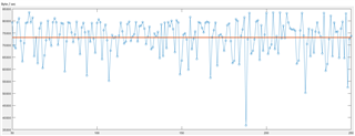

We implemented a joint bandwidth test (or speed test) for a radio channel by transmitting notifications.
Parameters set in SDK config:
  • #define NRF_SDH_BLE_GATT_MAX_MTU_SIZE  247;
  • #define NRF_SDH_BLE_GAP_DATA_LENGTH      251;
  • #define NRF_SDH_BLE_GAP_EVENT_LENGTH   320;
Parameters of the radio channel:
  • PHY 1M;
  • Connection interval 50 ms (40 units);
  • Transmiter power 0 dbm;
After the connection is established and the exchange of parameters, the host allows the transfer of notification characteristics of the test characteristic(size 244 bytes). Next, the device in the loop begins to send data.
According to the data plotted. I attach his part below.
The average speed was 73 kB / s. But the range is from 35 kB / s to 80 kB / s.
If I understand correctly, this is due to the peculiarity of the protocol. namely, transmission within the connection interval to the first error. As a result, during one connection interval, data can be transmitted, for example, 50 ms, and in the next only 10.
The question is: is it possible to somehow stabilize the data flow?

  • s a result, during one connection interval, data can be transmitted, for example, 50 ms, and in the next only 10.
    That is in essence the reason yes, and also why I recommend to always use the shortest possible connection interval.
    I suspect the max speed may drop yes with shorter interval, but you will get more consistent results, and I expect even better results in environment with interference. I don't think there is any specific "rule" here, but I would consider longer packets is always preferred if possible (less time on-air, less risk of collision, more time to transmit packets).

  • It's fixed yes, as configured by sd_ble_gap_tx_power_set().
