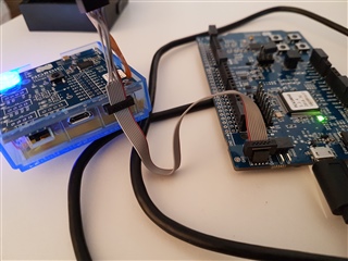

  • Yes i have connected it like this:

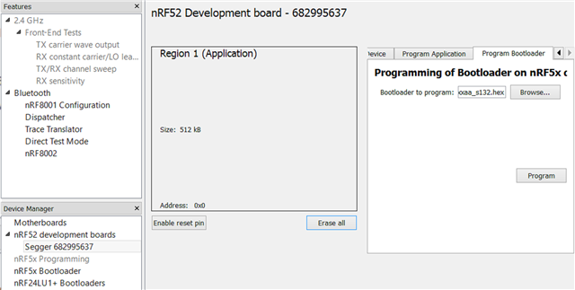

    The nRFgo studio looks like this for me, should the Thingy52 be visible here cause it seems like the nRF52 DK is visible for me.
  • I do not thing that cable has correct pinout. If you look at the connection on the cable on below image, the red line is swapped on your DK. If it is not correctly wired, you will program the DK rather than the Thingy. You can check this by flashing the blinky application to the DK before performing the erase on Thingy. If the DK stops running blinky, the Thingy have not been erased.
