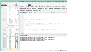

  • it shows the infomation:
    SDH:WARNING:sd_ble_enable: RAM start should be adjusted to 0x20002128
    SDH:WARNING:RAM size should be adjusted to 0xded8

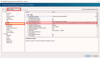

  • Are you sure you have edited both RAM_START and RAM_SIZE. This is the reason for your error message, but it is easy to miss something when editing the RAM and/or FLASH configurations. Confirm that you did the following:
    1. Open the project in SES.
    2. Right click the Project folder and click Options...
    3. Select Common configuration and click Linker, then double-click Section Placement Macros.
    4. Now the Section Placement Macros window will open, and you can edit RAM_START and RAM_SIZE to the exact values the SoftDevice suggests.
    5. Click OK and confirm that the values have changed in the Section Placement Macros before pressing OK to confirm the changes in your options.
    You should be able to build your project now.
    Simon
  • Yes,I have did what you mentioned before.
    It shows the information before I edit Section Placement Macros :
    FLASH_PH_START=0x0
    FLASH_PH_SIZE=0x80000
    RAM_PH_START=0x20000000
    RAM_PH_SIZE=0x10000
    FLASH_START=0x1f000
    FLASH_SIZE=0x56000
    RAM_START=0x20002c38
    RAM_SIZE=0xd3c8
    and I changed them to what SES suggested:
    but it also show the same error as before:
    so I don't have any idea for it.
