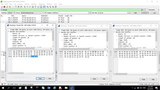

  • Hi Hung Bui, Thanks for you reply.
    my setup as following diagram:
      may
    I don't think there is many interference, because it is office and after office hours. Since Tx power is -16dBm, I may be too low. my idea is increase Tx to -10 dBm and add RSSI filter to prevent  Tx signal bypass reply note.
    I have used sniffer to capture Relay signal, normally it will be relay 3 packets at 37,38 and 39, but sometimes less then 3 packets, is it should be sniffer missed packets?
    Could I consult you following:
    what is default TTL value? where can check at source code  ?
    I can't find APP_UNACK_MSG_REPEAT_COUNT  = 2 , where can check repeat number at source code?
    Thanks
    MK Chen
  • You can find APP_UNACK_MSG_REPEAT_COUNT = 2 in our lightswitch client code (SDK v3.x)
    It's very simple we call access_model_publish() APP_UNACK_MSG_REPEAT_COUNT times when we send one message.
    The TTL value is set during provisioning&configuration , you can find it in the node_setup.c  at client_pub_state_set() or config_step_execute() at NODE_SETUP_CONFIG_PUBLICATION_ONOFF_SERVER event.
    Node that it's only for the light switch example. If you write your own code and your own provisioner, you may set it differently.
