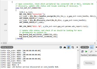

I am working on ble_app_blinky central and peripheral, I want to calculate the RSSI of peripheral after connection with central. I am able to calculate the RSSI value while it is scanning,
When I am trying to print the rssi in rtt from ble_event_handler in  main.c I am getting value as zero as shown below.
I have used these functions at same place
sd_ble_gap_rssi_start(p_ble_evt->evt.gap_evt.conn_handle, 0 , 0);
sd_ble_gap_rssi_get(p_ble_evt->evt.gap_evt.conn_handle,&p_ble_evt->evt.gap_evt.params.rssi_changed.rssi,&p_ble_evt->evt.gap_evt.params.rssi_changed.ch_index);
even though i am getting zero for rssi value. Please help to sort this issue

  • Hi Sumanth
    You have to call sd_ble_gap_rssi_start() initially so that the SoftDevice will start to report the RSSI. Depending on the parameters, you will get an event (BLE_GAP_EVT_RSSI_CHANGED) every time the RSSI change. Then you should be able to use the sd_ble_gap_rssi_get() event when the RSSI_CHANGED event occurs. Something similar to this should do.
    // On the connection event
    uint32_t err_code;
    m_conn_handle  = p_ble_evt->evt.gap_evt.conn_handle;
    err_code = sd_ble_gap_rssi_start(m_conn_handle, 10, 0);
    //On the RSSI_CHANGED event
    uint32_t err_code;
    int8_t rssi;
    err_code = sd_ble_gap_rssi_get(m_conn_handle, &rssi);
    Then you should be able to log the RSSI values.
