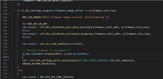

Hello everyone,
Currently I'm experiencing with some issues with serial bootloader in SDK 15.3. I'm using NRF52832 on my custom board together with main MCU that performs some other stuffs including firmware upgrade of NRF52. I have already successfully implemented serial dfu protocol in my firmware and it basically "emulates" what nrfutility is doing. Everything is tested and working fine on SDK 15.2 but not in 15.3. Currently, I'm trying to upgrade SD+BL+APP altogether. As it is well known, this is done in two separate processes. Firstly, SD+BL are flashed after that same procedure is repeated with application image. I turned on verbose debug during the upgrade to see every packet that is sent and received and I think I found the problem.
Actually, the problem happens when transferring last chunk of SD+BL image. In the normal procedure after every chunk is being transferred there are two subsequent commands:
1. Calculate checksum
2. Execute object
After every command I'm waiting for a response and I have the response to these commands except if it is the last chunk sent. After sending the command "Execute object (0x04)" there is no any response, but somehow nrfutility proceeds to application image upload. This makes me a problem because I'm stuck in waiting response which is not being sent from NRF52.
Is this a bug in latest SDK?
In attachment is part of the log file captured during upgrade with nrfutility.

    This is unfortunately a known problem that has been looked at, but that solution was left out due to size reasons.
    Can you try to implement this workaround, it should work.
    In the file components\libraries\bootloader\dfu\nrf_dfu_req_handler.c, add a delay on line 573:
            res.result = NRF_DFU_RES_CODE_SUCCESS;
            /* Provide response to transport */
            p_req->callback.response(&res, p_req->p_context);
            nrf_delay_ms(500); //ADDED A 500 MS DELAY
            if (NRF_DFU_SAVE_PROGRESS_IN_FLASH)
                /* Allowing skipping settings backup to save time and flash wear. */
                ret = nrf_dfu_settings_write_and_backup(NULL);
                UNUSED_RETURN_VALUE(ret);
    You also need to use #include "nrf_delay.h" at the top of the file.
    You can try various delays, it should work as long as you're delaying less then a second.
    Andreas

    I just noticed that I've copied the wrong code snippet, the delay should be added to the if statement, on line 573:
    Can you try to place it there?
    Andreas
  • Hi Andreas,
    I already supposed there is an error in snippet and placed delay inside if statement at line 573. There is no difference, no response to the last execute object command.
