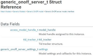

Now, I'm looking for the correct use of that information. I was reading in infocenter.nordicsemi that the function that Mttrinh told me (in the past question): generic_onoff_server_status_publish() from app_onoff.c --> app_onoff_status_publish(), uses other two functions and variables:
And those two functions, use more stuff (talking about their structures).
