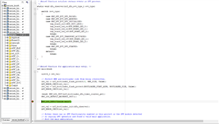

  • Another point, when we try to download and debug the bootloader code using IAR on our chip, we get this error:
    "Warning: Stack pointer is set to incorrect alignment Stack addr = 0xFFFFFFFF"
    This problem does not allow us to debug the code and see where it is stacked
