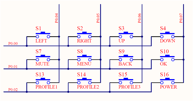

Sometimes nrf51822 not respond to pins toggle
We have a RCU on the chip nrf51822-qfaa s110.
Sometimes (the period is not deterministic) occurs a situation
that the remote stop responding to key presses.
But at the same time, the bluetooth connection is not broken.
Also if you send a command via bluetooth, you can make sure,
that the LEDs and buzzer are still working.
After about 120 to 180 seconds, the buttons start working again.
And then the remote works as if nothing had happened.
What could be the reason for this behavior?
Part of the code of processing buttons:

And schema for buttons:
