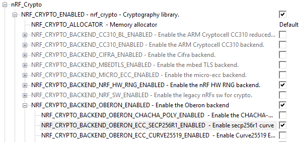

However, a bare-bones application (such as the nRF blinky example) seemingly requires 21 kB for just application dependencies
This doesn't take the memory footprint of other commonly used libraries into account (such as nordics cryptographic libraries, which appear to consume an additional 12 kB).
Is their any manageable ways to decrease the flash footprint of these required dependencies?
