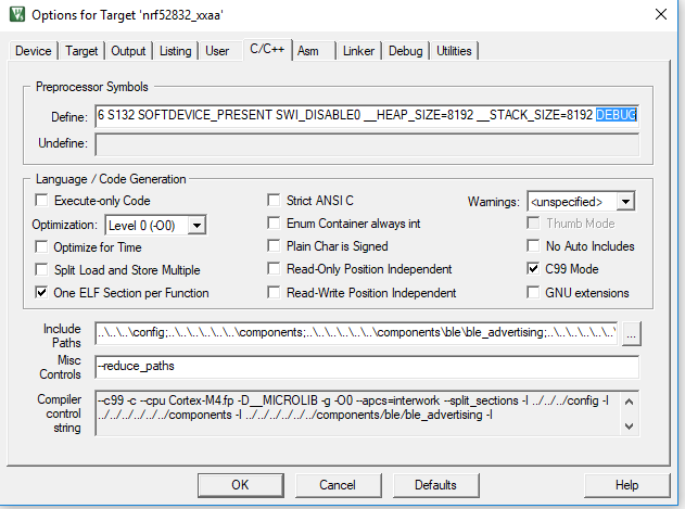

I am trying to implement a multilink central with UART. I had looked through the forum on all discussions in about this and followed this thread to come up with the program https://devzone.nordicsemi.com/f/nordic-q-a/41189/multilink-ble_app_uart---ble_app_multilink_central-3
I am running my central on a NFR52DK and using SDK15.2.0 with softdevice S132. I have 2 peripherial (Nordic Thingy) running the default  ble_app_uart program.
My program complies without errors and the multi-link central can also connect to 1 peripheral running the default  ble_app_uart program.
This is the RTT log:
0> <info> app: Multilink example started.
0> <info> app: Start scanning for device...
0> <info> app: Connecting to target 461B790D58E6
0> <info> app: Connection 0x0 established, starting DB discovery.
0> <info> app: ATT MTU exchange completed.
0> <info> app: Ble NUS max data length set to 0xF4(244)
0> <info> app: Discovery complete.
0> <info> app: Connected to device with Nordic UART Service.
However, if I try to turn on another uart peripheral, the multi-link central gives a FATAL error.
I put a break point inside app_errpr_handler_bare. And the error code 0x00000012 is pass into this function. Inside, error_info is as follows:
error_info.line_num = 0x200080E8
error_info.p_file_name: 0x00000003
error_info.error_code: 0x00000006
I am attaching my codes here. Hope to get some advise on how to proceed forward. Thanks in advance!

  • Hi Vidar,
    I am using Keil for development as I am not too familar with SES.
    In Keil, under project properties, I have set the optimization to Level 0. Is there a option to select debug or release in Keil? Now I am just debugging the program by selecting Debug -> Start/Stop Debug Session. I have put a breakpoint inside the file app_error.c and int he function app_error_handler_bare.
