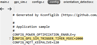

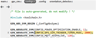

I tried to modify "configs.c" or ".config", modified CONFIG_GPS_SIM_TRIGGER_TIMER_MSEC = from 2000 to 10000.
But the device still sends GPS data every 2 seconds instead of 10 seconds, please guide me how to change trigger timer.

Generally, all configurations that are intended to override the default values should go into your prj.conf file for the project your working on.
So setting CONFIG_GPS_SIM_TRIGGER_TIMER_MSEC=10000 in prj.conf should help. Files such as configs.c and .config are generated by the build system based on the contents of all the configuration files in your project. Re-running the build system will overwrite any changes done manually there.
