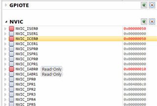

SPIM Problem, SDK 15.3 S132
Having problems getting SPI master to work with CC3100 wifi chip.
Using TI SPI porting diagnostics to verify operation.
Based on recommendations, attempted to switch to using nrfx spim approach.
If I run through the test loop by stepping over all the functions with the debugger it works fine.
If I run at speed I either get an assert or a flood of interrupts even if the CC3100 is disabled when the interrupt storm starts.
Running short on ideas on how to get this to work.
Disabled all other functions for now so only the basic gpiote and spi functions are being used.

Also I looked at the Registers when it was in this mode here is that info
