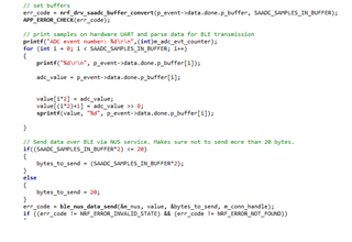

So, I am having hard time understading how the adc values are put in that message. The example uses 4 inputs and prints the values in termite just fine.
Also, why I can't open the log file. When I press the putton on nrf connect pc -app it does nothing at all. Is the log file saved somewhere?
I tried to use sprintf (picture below) to make sent values to string but it had no effect.
    nRF Connect lists the hexadecimal values of the bytes sent. For instance for the values on the bottom row of your screenshot, "31-39-38-00-C3-00-C6-00", the first four values correspond to the ASCII characters 1, 9, 8, <NUL>. So this is mostly a question about how to interpret the data (and how to encode it.) Termite, for instance, will display the ASCII characters representing the bytes it receives over UART. (And similar for sending.)
