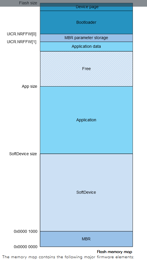

HOW much free flash size for mesh dfu?
hi,everyone
 when i test the mesh/example/dfu , it is upgrade scucessed,but when i combine it to switch_light example ,it was failed , it looks end the transfer too early ,so I think:
  1.why it will recivied a mesh event "NRF_MESH_EVT_DFU_END" while the transfer  is ongoing
  2.is becuse there not have enought free flash size for store the new firmware?
 3.how much kilobytes does the UICR  & Application data occupy? as show below in picture:

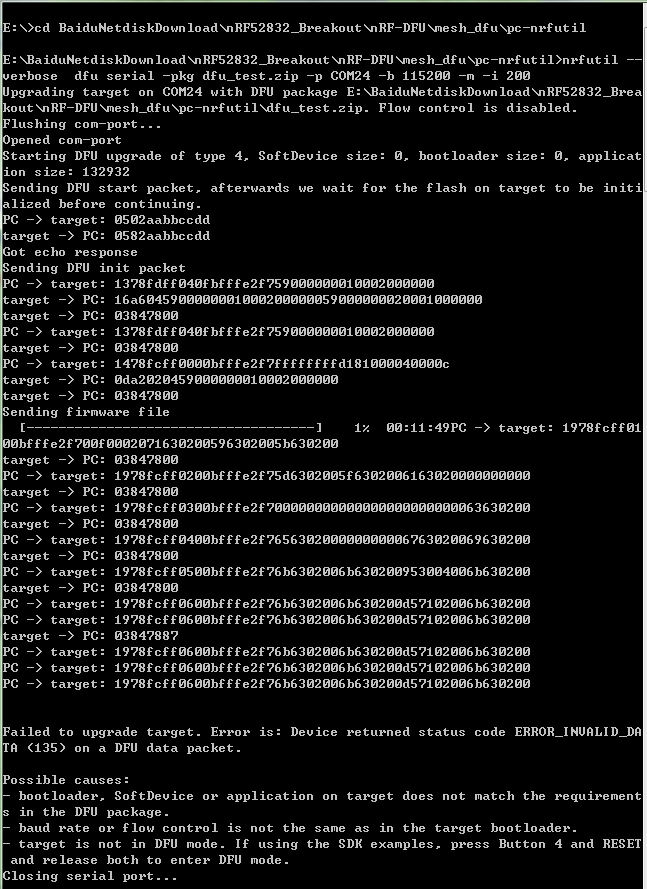

    nrfutil --verbose  dfu serial -pkg dfu_test.zip -p COM24 -b 115200 -m -i 300
    cmd /k echo.
    fail pic:
    sometimes it transfer few packets and failed ,sometimes it transfer many packets and failed,
    when failed ,it may return :03841982  or 03840082 , 03840084 , 03847884 , ,03847884 , 03847887

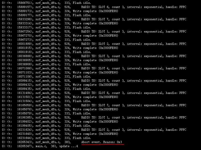

    and I also track the RTT viewer ,it show below when stopped:
    0x3 means as below in the source file:
    NRF_MESH_DFU_END_ERROR_PACKET_LOSS,                /**< Too many packets were lost in the transfer. */
    so i change the transmit interval  -i 1000 but it still not work.
  • So this is receiving the DFU image over Mesh, not serial, right?
    What compiler did you use to compile the projects? What type and what version?
    It looks like your serial device is rejecting the packet, and hence, the other device receiving the DFU image is not getting any more packets.
    I don't know the internal state machines too well, but are you sure you signed the DFU image with the correct keys? And that it is the same that is used in the device_page for your devices? Did you use your key in the device page?
    one device over serial ,the other over mesh ,both are scucessd in  light_switch_proversioner

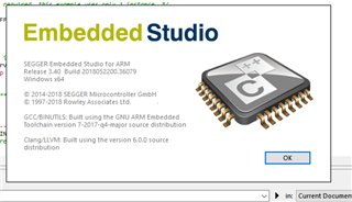

  • ycp said:
    i use the mesh3.1.0/example/light_switch , SES  IDE , i nerver modify the project options , i guess it is GCC show in the as show in the option->compiler . i
     So you compile in SES, right?
    Can you open SES and click "Help"-> About Segger Embedded Studio and take a screenshot of the window that pops up?
    What SES release version do you have, and what GNU ARM Embedded Toolchain version do you have?
    I you don't have SES version 3.40, can you try to swich to this version (It is the recommended version in the SDK release notes).
    I know it sounds weird, but I have seen other customers having issues that was resolved by changing to this version of the compiler. Even though I don't know exactly what the problem is, different compiler versions behaves a bit different when optimization is enabled, and if there is a mismatch between the precompiled files and the files that you compile, it may lead to some weird behavior.
    Let me know what version you have, and if it isn't 3.40, does it help to change to this?
