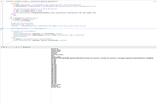

I added print on line 245 and on iphone 6 can receive complete image data and display but on Iphone X , iphone X Max the data will stop before image data complete

What is the purpose for adding the print statement at that particular line number?
The print statement is output the log for show the received data size and base on the log we know the data is not complete.

Slow down the SPI to "NRF_SPIM_FREQ_125K" to holding the BLE communication back can make the iPhone X receive data complete sometime but this solution still not stable.
iPhone X seem limited BLE 5 data transfer speed.

Just installed Sniffer V2 and capture samsung S8 (image data complete) and iPhone X (image data not complete) but seem normal attached capture data for your ref.

Yes,I agree. I cannot see anything indicatiing that the notifications from the nRF52 device( i.e. the characteristic with handle 0x000f) is not received correctly. This could indicate that this is an issue inside the application and unrelated to the BLE communication.
