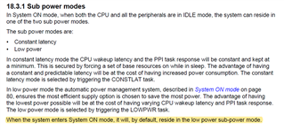

First, as i attached below, in 7.2.1 of PS, CPU current has mA units (e.g. CPU current, running from flash, cache disabled,
DCDC 3V = 3.9 mA). Does it means that CPU consumes the 3.9 mA per unit times? I don't understand what those current
value indicates.
If the above current (e.g. 3.9 mA) stands for, minimum current consumption on nRF52832 should be higher than 3mA.
However, many low power applications mentioned in this forum aim at much lower application (< 200 uA).
Also, in 18.3.1 in PS, it saids that "When the system enters System ON mode, it will, by default, reside in the low power
sub-power mode" and in ultra-low power (mode?), current consumption level is specified in 17.1.1 lower than 2 uA.
Therefore, I don't know which information is right.
