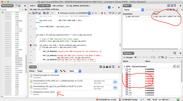

  • Thanks for the detailed explanation.
    Can you built the debug the application?
    You should be able to see how much RAM you need to allocate to the SoftDevice by examining the p_app_ram_start variable in nrf_sdh_ble_enable() which is called in ble_stack_init().

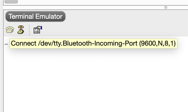

    To get the LOG output you need to make sure that NRF_LOG_ENABLED in sdk_config.h is set to 1. You also need to set which backend to use by setting either NRF_LOG_BACKEND_RTT_ENABLED or NRF_LOG_BACKEND_UART_ENABLED to 1.
    If its not the SD ram setting that is incorrect, then please set a app_error_handler_bare() in app_error.c and then look at the call stack if you hit the breakpoint, this will tell you which function that generated the error.

  • I think my problem may be that I don't know how to configure RAM memory after adding a service. Where can I configure the memory through the serial port? Similar to the following example: <warning> nrf_sdh_ble: RAM starts at 0x200020E0, can be adjusted to 0x200020F0.
    <warning> nrf_sdh_ble: RAM size can be adjusted to 0xDF10.
    <error> nrf_sdh_ble: sd_ble_enable() returned NRF_ERROR_NO_MEM.
  • hello,I have tried a lot about your advice,and now there is my problem.
    1.stopped by vector catch
    I set the breakpoint and debugging ,it's the screen shot.
    and the variable 'p_app_ram_start' shows that "not found', and then I change the address the terminal emulator,like the image.
            I want to see the RAM address I need to modify in it, but I haven't seen anything. How can I solve these two problems? This is my code (main.c and sdkconfig.h), and build and run are not reporting errors.
