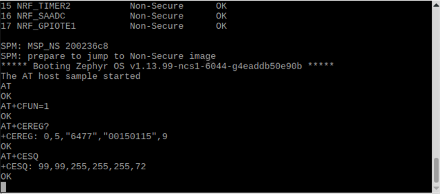

I'm having an issue with scripting AT comands directly into the code of the nRF9160. I'm a novice at all this so I apologise if the mistake is an obvious one.
Inside the at_client.c, I have added another function that is called every ten seconds with the aim to change the status of the modem from on start-up CFUN=4 to CFUN=1. To do this I have looked at how the at_client code handles incoming UART messages and added a static const char with the value of "AT+CFUN=1* and altered the normal UART code to allow this function to run this char as if it was the incoming UART response. I'm aware that this only needs to be done once but it's just to get me started with a scripted command. Below is the function added to at_client.c

I can see the timer is calling the function as both printk lines are fired out to the UART (using minicom) as it calls the function but the actual AT command doesn't seem to trigger a UART response or a change in the modem status. Below is the UART output from reset. AT+CFUN? command entered by myself via minicom.

***** Booting Zephyr OS v1.13.99-ncs2 *****
The AT host sample started
AT+CFUN?
+CFUN: 4
OK
all ok
timer triggered!
AT+CFUN?
+CFUN: 4
OK
all ok
timer triggered!
all ok
timer triggered!
a
