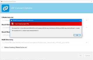

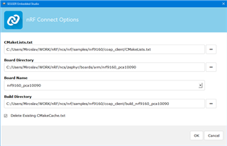

Hello all. I have problem with open sample project for CoAP protocol. Please see screen.

  • Hello. Thank you for your response.
    Yes, I can open the project, but I can't compile it.
    But I must switch
    mcuboot to git commit f50054d9986a2c565023bd159b653988acd261af
    nrfxlib to git commit a9e054cd16eccd35af65ecbc9c201719de0b2400
    zephyr to git commit 82fe1f9dfcf0e100d6fc952c07cf63d63aa08a0e
    and then I can open the project. But then I have a problem with compiling

  • Try switching to master and see if that helps.

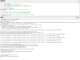

  • if I switch to master branch then I have a problem opening the project.
    Loading solution coap_client.emProject
    Executing load commands
    cmake -GNinja -DBOARD=nrf9160_pca10090 -DBOARD_DIR=C:/Users/Miroslav/WORK/nRF/ncs/zephyr/boards/arm/nrf9160_pca10090 -DZEPHYR_TOOLCHAIN_VARIANT=gnuarmemb -DGNUARMEMB_TOOLCHAIN_PATH=C:/gnuarmemb/8 2018-q4-major -BC:/Users/Miroslav/WORK/nRF/ncs/nrf/samples/nrf9160/coap_client/build_nrf9160_pca10090 -HC:/Users/Miroslav/WORK/nRF/ncs/nrf/samples/nrf9160/coap_client -DEXTRA_KCONFIG_TARGETS=menuconfig_ses -DEXTRA_KCONFIG_TARGET_COMMAND_FOR_menuconfig_ses=C:/Users/Miroslav/WORK/nRF/EmbeddedStudio_ARM_Nordic_v416_win_x64/arm_segger_embedded_studio_v416_win_x64_nordic/html/configure_nordic_project_menuconfig.py
    -- Using application from 'C:/Users/Miroslav/WORK/nRF/ncs/nrf/samples/nrf9160/coap_client'
    Zephyr version: 1.14.99
    -- Found PythonInterp: C:/Python37/python.exe (found suitable version "3.7.2", minimum required is "3.4")
    -- Selected BOARD nrf9160_pca10090
    -- Cache files will be written to: C:\Users\Miroslav\AppData\Local/.cache/zephyr
    -- Loading C:/Users/Miroslav/WORK/nRF/ncs/zephyr/boards/arm/nrf9160_pca10090/nrf9160_pca10090.dts as base
    -- Overlaying C:/Users/Miroslav/WORK/nRF/ncs/zephyr/dts/common/common.dts
    Parsing Kconfig tree in C:/Users/Miroslav/WORK/nRF/ncs/nrf/samples/nrf9160/coap_client/Kconfig
    C:/Users/Miroslav/WORK/nRF/ncs/nrf/samples/nrf9160/coap_client/prj.conf:12: warning: attempt to assign the value 'y' to the undefined symbol LTE_LINK_CONTROL
    C:/Users/Miroslav/WORK/nRF/ncs/nrf/samples/nrf9160/coap_client/prj.conf:13: warning: attempt to assign the value 'n' to the undefined symbol LTE_AUTO_INIT_AND_CONNECT
    C:/Users/Miroslav/WORK/nRF/ncs/nrf/samples/nrf9160/coap_client/prj.conf:16: warning: attempt to assign the value 'y' to the undefined symbol BSD_LIBRARY
    C:/Users/Miroslav/WORK/nRF/ncs/nrf/samples/nrf9160/coap_client/prj.conf:17: warning: attempt to assign the value 'n' to the undefined symbol BSD_LIBRARY_TRACE_ENABLED
    C:/Users/Miroslav/WORK/nRF/ncs/nrf/samples/nrf9160/coap_client/prj.conf:21: warning: attempt to assign the value 'y' to the undefined symbol AT_HOST_LIBRARY
    C:/Users/Miroslav/WORK/nRF/ncs/nrf/samples/nrf9160/coap_client/prj.conf:24: warning: attempt to assign the value 'y' to the undefined symbol NRF_COAP_LIB
    Loading C:/Users/Miroslav/WORK/nRF/ncs/zephyr/boards/arm/nrf9160_pca10090/nrf9160_pca10090_defconfig as base
    Merging C:/Users/Miroslav/WORK/nRF/ncs/nrf/samples/nrf9160/coap_client/prj.conf
    C:/Users/Miroslav/WORK/nRF/ncs/nrf/samples/nrf9160/coap_client/prj.conf:25: warning: attempt to assign the value '1' to the undefined symbol NRF_COAP_PORT_COUNT
    Error: Aborting due to non-whitelisted Kconfig warning
    'C:/Users/Miroslav/WORK/nRF/ncs/nrf/samples/nrf9160/coap_client/prj.conf:12: warning: attempt to
    assign the value 'y' to the undefined symbol LTE_LINK_CONTROL'. Note: If this warning doesn't point
    to an actual problem, you can add it to the whitelist at the top of
    C:/Users/Miroslav/WORK/nRF/ncs/zephyr/scripts/kconfig/kconfig.py.
    CMake Error at C:/Users/Miroslav/WORK/nRF/ncs/zephyr/cmake/kconfig.cmake:194 (message):
      C:/Users/Miroslav/WORK/nRF/ncs/zephyr/cmake/app/boilerplate.cmake:500 (include)
      CMakeLists.txt:9 (include)
    Project load failed
    Reported error: solution load command failed (1)
