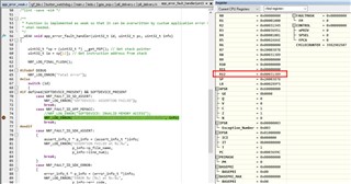

Observating the Stack pointer, ia == R12 = 0x00031389  (note that the call stack is empty...), I found that the responsible is the function "cli_ble_uart_read", used when a new command is received

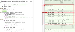

Here the address of the function cli_ble_uart_read:

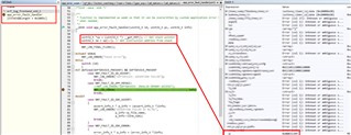

As you can see in the pictures, the MWU->PERREGION register are all 0, apparently, there are not a SD violation:
Here the CPU registers:
