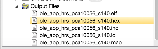

I cannot find the dfu_buttonless service when i finsh adding dfu buttonless service.(nrf52840/sdk15.3.0)
hello,everyone,
I use the Infocenter Guide, and
I changed my section placement marcos by the warning:
FLASH_PH_START=0x0
FLASH_PH_SIZE=0x100000
RAM_PH_START=0x20000000
RAM_PH_SIZE=0x40000
FLASH_START=0x26000
FLASH_SIZE=0xda000
RAM_START=0x20002aa8
RAM_SIZE=0x3d558
and then I "build and run" in order to get the output.hex.After this,I make the setting file and mix the settings.hex,app.hex,softdevice.hex and bootloader.hex by using the code below:
nrfutil settings generate --family NRF52840 --application app.hex --application-version 1 --bootloader-version 1 --bl-settings-version 1 settings.hex
mergehex --merge bootloader.hex s140_nrf52_6.1.1_softdevice.hex --output production_final1.hex
mergehex --merge production_final1.hex app.hex --output production_final2.hex
mergehex --merge production_final2.hex settings.hex --output production_final.hex
nrfjprog --eraseall -f NRF52
nrfjprog -f NRF52 --program "production_final.hex" --verify
nrfjprog --reset -f NRF52

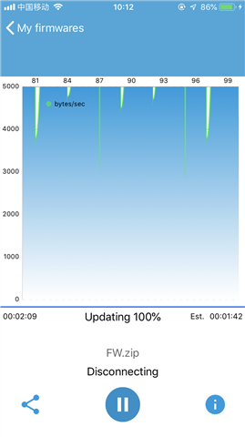

finally I can connect the nrf52840 which is named "UART service" by my phone,but I can only find that there is only a service named UART service,I can't find the dfu service, what should I do?
    I tried to reproduce this by adding the DFU service to the ble_app_uart example in SDK 15.3.0, but it worked here. Please try to program the merged hex attached below and see if you get the same result.

  • Hi Berg,
    I just open the hrs example and click "build and run",and then I use the output file(hex) in the project,like the image:
    after I use the command
    nrfutil pkg generate --application app_new.hex --application-version 1 --application-version-string "1.0.0" --hw-version 52 --sd-req 0xB6 --sd-id 0xB6 --softdevice s140_nrf52_6.1.1_softdevice.hex --key-file priv.pem FW.zip
    finally I use the ZIP file to update.but the result is shown like my last reply,When start to update,led1 and led3 will be on, and when updated to 100%, led1 and led2 lights will be on, then after 5 seconds, only led1 starts to flash, the service becomes the initial service (UART service and dfu service),and on my phone,there is always like this:
    wha's wrong with the step?
    best regards,
    zhong
  • Hi Zhong,
    To confirm it's not attribute caching, please reboot your phone, then re-connect to the peripheral through nRF connect and see if you still see the UART and DFU service.
  • Hi Vidar,
    I reboot it, and the same situation occured,and then I run the bootloader in ses,it's named DfuTarg and I use the dfu service,It also happened the same situation(when comes to 100% ,It will always in 100% and after several seconds,It will go back to orignal state(DfuTarg)).maybe my update-zip.file is incorrecct.It's my process:
    1.get the output file.hex in example hrs.and named "app_new.hex"
    2.use command:
    and I download the zipfile and use it.
    coula you please help me find the error?looking forward to your reply.
    best regards,
    zhong
