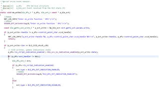

I put some NRF_LOG_INFO and SEGGER_RTT_Write in different functions of the ble_dfu.c :
In the switch of void ble_dfu_on_ble_evt(ble_dfu_t * p_dfu, ble_evt_t * p_ble_evt),
in each case function : on_rw_authorize_req(p_dfu, p_ble_evt) , on_write(p_dfu, p_ble_evt); on_hvc(p_dfu, b p_ble_evt)
in function static void on_ctrlpt_write(ble_dfu_t * p_dfu, ble_gatts_evt_write_t const * p_evt_write)
I can notice in JRTT Viewer that the program enters into the function static void on_write(ble_dfu_t * p_dfu, ble_evt_t const * p_ble_evt) and goes into : if (p_evt_write->handle != p_dfu->control_point_char.cccd_handle), I got a return so they are different... (17 and 23)
:INFO:Enter on_write function ' DFU'
:INFO:p_evt_write->handle 17, p_dfu->control_point_char.cccd_handle 23
