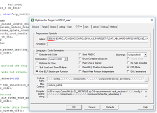

    If you have logging enabled, it may also be a good idea to add DEBUG to your preprocessor defines:
    It will make sure your log prints the errors that are caught by the APP_ERROR_CHECK(err_code).
