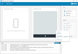

    However, when I build the `spm` sample and write it to the nRF9160 and also build and download the `coap_client` sample, the old application `at_client` is started on boot.
    I can see in the nRF Connect Programmer that there are two applications in memory, one at 0x00008000 (`coap_client`) and one at 0x00040000 (`at_client` (flashed from a .hex file from this forum)).
    So the `spm` loads the application from 0x00040000, but SES flashes it at 0x00008000. What am I doing wrong?
    I use the board without `_ns` when building `spm` and the board with `_ns` when building `coap_client`.
