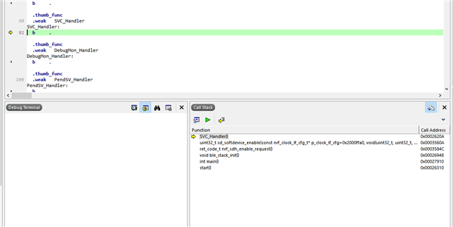

  • Thank you. This worked but now during BLE stack initialization, it goes into svc handler. Screenshot below. Can you help me?
  • Is the SoftDevice flashed to the chip?
    Note that our BLE SES projects in the SDK will load the SoftDevice for you:
  • Yes its flashed. I use the soft device to flash the s132 soft device hex file.
    Note: When I flash the IAR compiled hex, it works but when I flash the GCC/SES compiled it doesn't. Stuck now as per screenshot above.
