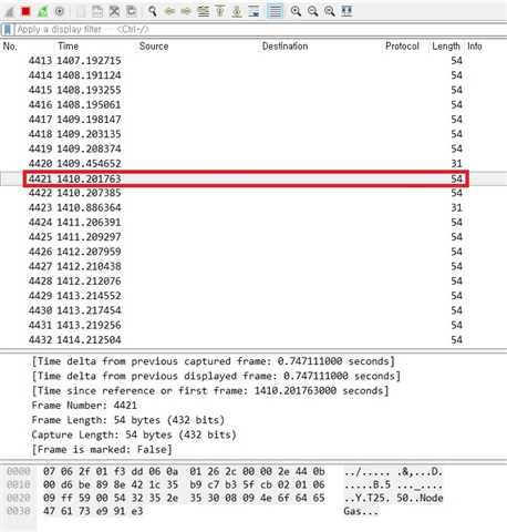

First > I wonder about that why the advertising packet length is 54 bytes in my application?
As attached below, i used BLE sniffer v1.0.1 and used BLE dongle and Wireshark v2.4.2.
Also, I confirmed that my information in the packet. There were 22 bytes of PDU
However, i can not understand that why advertising packet length is 54 bytes?
LL packet format in BLE v4.2 is
=> Preamble (1 bytes) + Access address (4 bytes) + Adv PDU (up to 37 bytes) + CRC (3 bytes)
I thought that in the advertising event, the packet length couldn't extend 45 bytes (1 Mbps and uncoded case)
In my application, it should be 30 bytes (1+4+22(PDU)+3).
When the 24 bytes come from?
Is there anybody know about this?

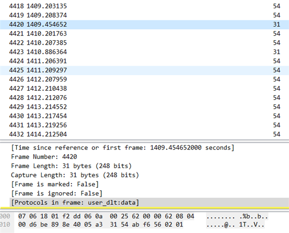

Third > Lastly, This is also related to BLE sniffer packet.
My application broadcasts 54 bytes of advertising data (I currently don't know about this) in about 1 second, through 3 channel.
However, I don't know about the certain data. As attached below, there are other data having 31 bytes of size.
Is there anybody know about this packet (?) or data(?)
In addition, the size of this data has changed timely (e.g. 29...->... 30...-> 31... 30.. 31..)
At least, I want to know that what kinds of data it is.
