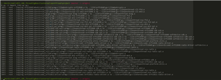

Hi.
I am not family with the Nordic product, this is the first time.
I just download "nRF5_SDK_for_Thread_and_Zigbee_v3.0.0_d310e71.zip",  because I plan to build my NCP with my custom board(base on nRF52840).  then a follow the "Building the latest OpenThread libraries" from Inforcenter, I follow the instructions "Building the library with GCC on Windows", the step 2 say: "Run the build_gcc_libs.bat script to build all of the libraries.", but I can not find "build_gcc_libs.bat" file.
or how can I rebuild "build_gcc_libs.bat".
Cai.

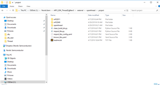

    1. Copy the openThread master folder to this location in the SDK: (Thread and Zigbee SDK v3\external\openthread\project)
    (Note I renamed it from openthread-master to openthread)
    2. Open the nrf52840 folder and the openthread folder.

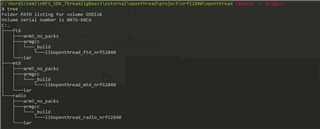

    It should give you this output (or similar):
    C:\NordicSemi\nRF5_SDK_ThreadZigBeev3\external\openthread\project\nrf52840 (master -> origin)
    λ bygg2.bat
    make -C nordicsemi_nrf52840/driver/armgcc
    make: Entering directory `C:/NordicSemi/nRF5_SDK_ThreadZigBeev3/external/openthread/project/nrf52840/nordicsemi_nrf52840/driver/armgcc'
    Creating library: ../../../nordicsemi_nrf52840/driver/armgcc/libnordicsemi-nrf52840-radio-driver.a
    Done
    make: Leaving directory `C:/NordicSemi/nRF5_SDK_ThreadZigBeev3/external/openthread/project/nrf52840/nordicsemi_nrf52840/driver/armgcc'
