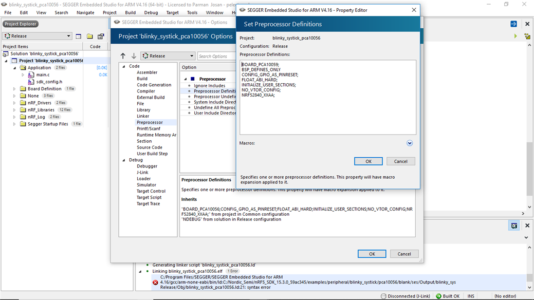

I was working on blinky_systick Example(Path - nRF5_SDK_15.3.0_59ac345\examples\peripheral\blinky_systick\pca10056\blank\ses)which is available for 10056 board but I follow the
Adapting SDK projects for the nRF52840 Dongle tutorial (https://devzone.nordicsemi.com/tutorials/b/getting-started/posts/nrf52840-dongle-programming-tutorial). And changed "Preprocessor Definitions" & "linker configuration"( see the attachments).
But still, I got an error(See the attachment).
                                                              waiting for your quick response

  • The error is a Linker error.
    Before that, there's a whole load of Warnings.
    I suggest that you sort out the Warnings first - they may well be (or point to) the cause of the error...

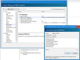

  • Hi.
    You have to modify the Common configuration, not the Release.
    Then the pca10059.h file should be included.
    Also I suggest you do as awneil suggested, and clean up all the warnings you have in your project.

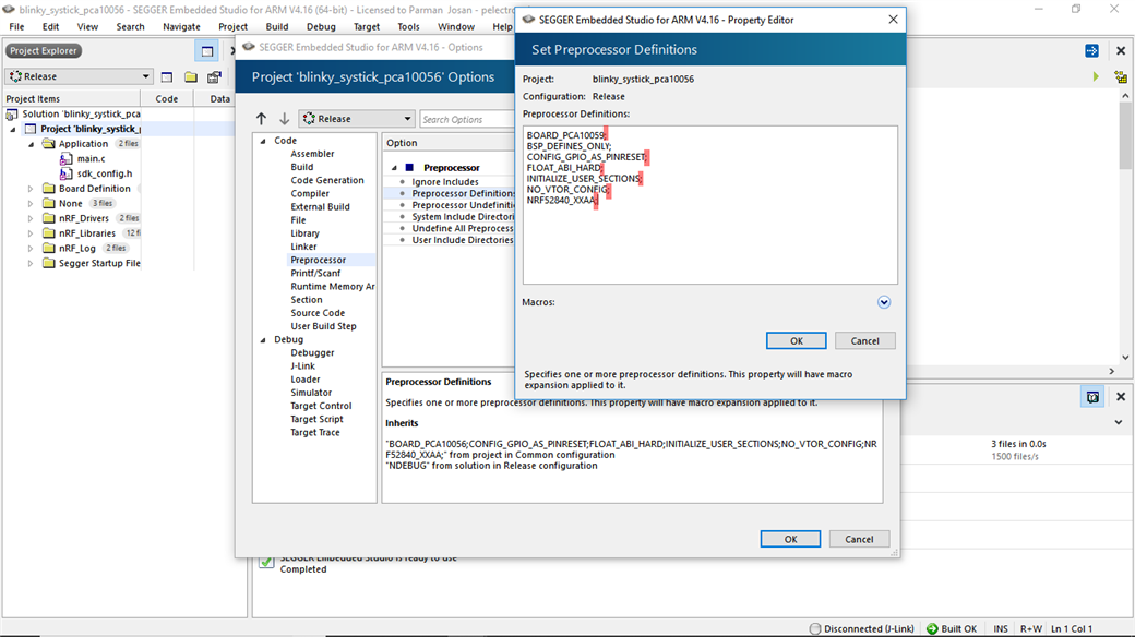

       I got the reason of error -  I added ";"  after the macros (see the image) -
