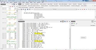

  • Yes, i had noticed it. I totally agree with you about get message, i test again and mostly i receive 1 status message but sometime i receive 2 status message. I think it fine but i wonder if i can ask you another question about status response, when i transfer data from client to server by function use generic_onoff_client_set_unack();. I always receive 2 message status. How can i fix it? I only need response status message only 1 one time, it make me confuse so much.
    Thanks you
  • Are you sure you are using generic_onoff_client_set_unack()? You should not receive a status message if the message is unacknowledged. If this is the case, let me know & I will test a bit myself.
  • yes, i alaways receive two message status, can you help me test again and find out the way of this issue ?
