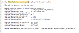

    The way used to add the characteristic in ble_dfu_buttonless_char_add ( the one that use SEC_JUST_WORKS in my soft)  is different that the way i used:
