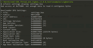

    Sorry for not clarifying enough. My idea of your problem was that you wanted to do a upgrade of your client firmware without having to do OTA, correct?
    About the settings:
    As you can see here, there is many "settings" and each with an purpose. For example, the CRC value (0x67E076C0) is checked by the bootloader when it is booted, if the value is not correct the device will not boot. That is why you have to generate new settings page when you upgrade your device. The settings page also has to be signed with the private key you used to generate the bootloader and the client with.
    Is this more clear?

    AnnaR said:
    Does the bootloader settings also changes with each client firmware update, and need to be regenerated each time by nrfjprog? So, it appears as I cannot automate somehow this process via Segger Embedded Studio?
     Yes, it does change and you need to regenerate it with nrfutil.
