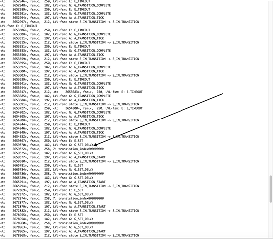

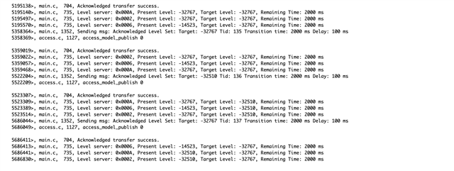

I am currently publishing messages to a group of servers on a 10 second interval. This works well for a while but after a few minutes some of the nodes stop handling the message. They receive the message but do not call the callback function in the main. I have traced the problem to the function below. The if condition stops becoming true and thus the onoff_set_cb doesn't get called allowing me to update the value in the main. I believe it has something to do with the delay and transition time as they are not becoming zero causing the if condition to be false. When I print out the delay and remaining time they both stay at 50 and 100 and never become zero.  If I force the condition to become true(like in the code below) I never have problems with the nodes not handling the message. I am also having the same problem when using the level client and server.  I attached a screen shot of the debugger from the level client node. notice how it gets an acknowledgment back but some of the nodes aren't being set to the correct level.
I am using acknowledged messages and I am receiving a status message back from the server nodes
I am using mesh sdk 3.0.0 and stock sdk 15.2

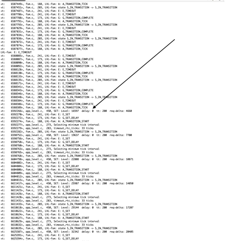

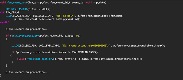

  • Sorry for the long pause on this topic. It does happen on the unmodified dimming server example from the SDK. I started debugging the FSM and found where it is happening. As soon as transition_index@@@@ is printed out the callback function in the main stops being called and the FSM slows down. Again this is happening when the server receives a bunch of messages in a short time about 30 over 8 seconds. You could probably reproduce by making a loop that publishes a generic_level over a set interval.
    Heres another screen shot from the stock Dimming Server indicating when the LED stops responding.
    P.S. After waiting for a minute or so it starts working again.

    There are some known issues in examples\common\src\app_level.c, some of which might explain issues like the one you are seeing. See Multiple issues with app_level.c. For the issues listed in that post, 1 to 4 is already fixed and will be part of next nRF5 SDK for Mesh release. 5 is something we do not currently plan to implement (i.e. you must do that yourself if you want that behavior.) The fixes (all of them in app_level.c) are as follows:
