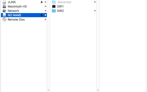

nrf52840 DK USBD MSC multiple directories bug
While developing code for our custom board, we ran into a filesystem corruption issue with fatfs+qspi block device and multiple directories. We were able to reproduce the bug in the usbd_msc example in SDK 15.2 AND 15.3 using nRF52840 DK:
1. Erase qspi external flash via `nrfjprog --qspieraseall`
2. Modified the example code to call f_mkfs() if no file system is found. After successful init, I create two directories and then two files within each of the two directories. See attached code.
3. Ran the program and found two files in the two directories as expected. Ejected the nRF DK MSC volume and rebooted the chip to find the first directory corrupted as shown here:

  f_mkdir("dir1");
  f_mkdir("dir2");
  char fpath[50] = "dir1/";
  strcat(fpath, filename);
  ff_result = f_open(&file, fpath, FA_CREATE_ALWAYS | FA_WRITE);
  if (ff_result != FR_OK) {
    NRF_LOG_ERROR("\r\nUnable to open or create file: %u", ff_result);
    NRF_LOG_FLUSH();
    return;
  ff_result = f_close(&file);
    NRF_LOG_ERROR("\r\nUnable to close file: %u", ff_result);
    NRF_LOG_FLUSH();
    return;
  char fpath2[50] = "dir2/";
  strcat(fpath2, filename);
  ff_result = f_open(&file, fpath2, FA_CREATE_ALWAYS | FA_WRITE);
    NRF_LOG_FLUSH();
    return;
    NRF_LOG_FLUSH();
    return;

I've applied the qspi block device patch explained here: https://devzone.nordicsemi.com/f/nordic-q-a/36654/usbd_msd-disk-initialization-fails-in-usb-unplug-with-sdk15-0/141462#141462
To summarize, opening files in one folder seems to corrupt/destroy files in another folder. This is reproducible every single time. Things I've tried in our custom firmware:
1. Turn on FS_REENTRANT and supply semaphore functions via FreeRTOS
2. Add delay between creating a file in dir1 and a file in dir2
