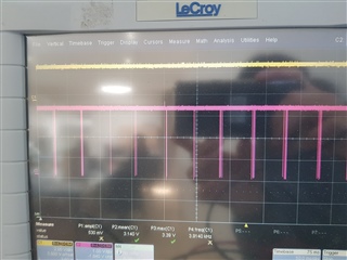

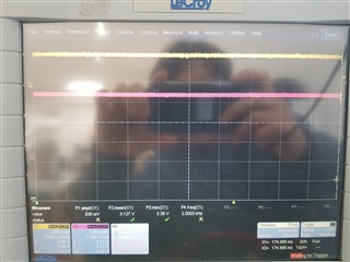

Sleep current with FreeRTOS
  I use  NRF52832 and nRF5_SDK_15.2.0 for our custom board.
  Also, FreeRTOS(Tickless IDLE is enabled) is used. And, System ON mode is used for sleep mode.
 Now, I am testing sleep mode. But sleep current is higher than I expected.
 Average Current is 500~600uA when device is sleep mode when System ON mode.
 I checked System OFF mode also. When device is system OFF mode, average current is 50uA.
 I brought some clean up code(GPIO, Peripheral) from System OFF mode test.
 So, It is supposed that CPU consumes most of current consumption.
I searched in nordic community. And  I gave some modification based on FreeRTOS suggestion
For reference,  I also uploaded port_cmsis_systick.c file which is using currently.

        nrf_gpio_pin_set(10);
        if ( xModifiableIdleTime > 0 )
            PWR_MGMT_FPU_SLEEP_PREPARE();
#if 0  // With FreeRTOS sd_app_evt_wait increases power consumption with FreeRTOS compared to _WFE (NRFFOSDK-11174)
#ifdef SOFTDEVICE_PRESENT
            if (nrf_sdh_is_enabled())
                nrf_gpio_pin_set(24);
                uint32_t err_code = sd_app_evt_wait();
                nrf_gpio_pin_clear(24);
            else
#endif // (NRFFOSDK-11174)
                /* No SD -  we would just block interrupts globally.
                * BASEPRI cannot be used for that because it would prevent WFE from wake up.
                do{
                    __WFE();
                } while (0 == (NVIC->ISPR[0] | NVIC->ISPR[1]));
        configPOST_SLEEP_PROCESSING( xExpectedIdleTime );
        nrf_gpio_pin_clear(10);

I checked __WFE() part in port_cmsis_systick.c with two GPIOs to check CPU is sleep or not.
As you can see the code, I used Pin 10, Pin 24.  When device is sleep mode, Pin 10(Yellow signal in image below)
is not changed which means OS is in sleep mode. But Pin 24( Red signal in image below) is kept changing(It occured about 48ms) by another interrupt.
I guess it caused by soft device. Because softdevice use RTC and Timer.
Is My guessing correct?
Do I need to do something to make soft device sleep? or Do I miss something?
Additionally, I also checked sd_app_evt_wait() part in port_cmsis_systick.c.
As you can see, Two GPIOs are not changed when enter IDLE mode. Also, Current consumption is same as test above.
It supposed that same situation is occurred in inside of softdevice.
Please give me any help.

    Your observations are correct.
    the sd_app_evt_wait filters the SD events and makes sure that the application is not awake until there is any app specific interrupt/event.
    The change we did to add #if 0 for (NRFFOSDK-11174) was on some specific chips which has poor sleep performance for sd_app_evt_wait. But it looks like you should not use this patch. Please change the codeto use sd_app_evt_wait in your case to get better
    If your system is not going to sleep with sd_app_evt_wait, then I would suggest you to print out the value for NVIC->ISPR[0] and NVIC->ISPR[1] separately to see if there are any application specific interrupts that are pending and your application is not servicing them for some reason.
