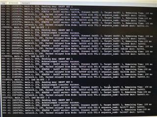

Log file
I added the log to the network.c file, as in the following code

The messages sent via the generic_onoff_client model (with ACK for both groups of nodes) are all received by the nodes of the network, both from those in range and those out of the client range, but, for each on-off command sent, I riceive back the STATUS of all the interested nodes only from group1, never from group2 (see log file above).
Could it be a network congestion problem due to packets exchanged between the nodes of group2, being these 7 to receive the command instead of 3 as in group 1? Or could it be trivially that I need to increase the TTL?
