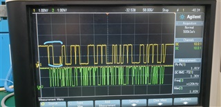

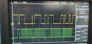

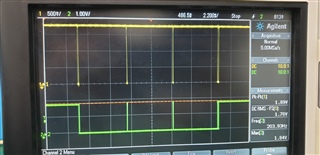

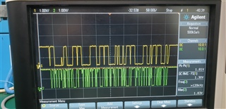

    Thanks for the help. I do get a good waveform now with the acquisition tip you gave. Sample of the waveform is below:
    I was able to check on the waveform that I get and modify the code to get the required result. Basically I was sending a write command but this is already sent when I call nrf_drv_twi_tx. I got rid of that statement and send only the command for measurement and then read.
    Thanks again for the help.
