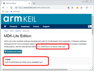

  • Hi Rohit,
    That's because each project has a different size, it will depend on what kind of modules are included in the example, etc. If you do any modifications to the projects and add more modules to it then the size will increase as well. Maybe in the past you have only worked with small projects in Keil and that's why you haven't experience this problem before.
    And in general you should try to keep the path short. Windows has a limitation to its path length, with max path length being 255 characters. I suggest to copy all the SDK right under C:\ or maybe make a folder for your nordic SDK like C:\SDK. Some examples have dependencies with longer paths than others, so that's why you are experiencing this error in some examples but not in all.
