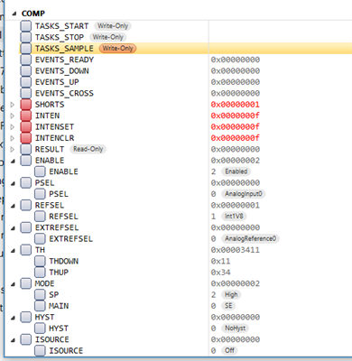

I have attached the code.
I would like to compare one of the external inputs to an internal reference. Is there anything else to do to make this work? Maybe configure the pin itself to act as analog input or similar?
  • I have attached a potentionmeter to AIN0
  • I verified the voltage on the board at pin P0.03 - Sweeping it from 0 to 3V and back
  • The comparator always returns 0.
  • The ready event is triggered successfully.
Any ideas?

    nrfx_comp_config_t comp_config;
    comp_config.reference           = 1;
    comp_config.main_mode           = 0;
    comp_config.threshold.th_down   = NRFX_VOLTAGE_THRESHOLD_TO_INT(0.5, 1.8);
    comp_config.threshold.th_up     = NRFX_VOLTAGE_THRESHOLD_TO_INT(1.5, 1.8);
    comp_config.speed_mode          = 2;
    comp_config.hyst                = 0;
    comp_config.input               = NRF_COMP_INPUT_0;
    comp_config.interrupt_priority  = NRFX_COMP_CONFIG_IRQ_PRIORITY;
    comp_config.ext_ref             = NRF_COMP_INPUT_1;
    nrfx_comp_event_handler_t comp_event_config = comp_callback;
    error = nrfx_comp_init(&comp_config, comp_event_config);
    printf("error: %i \n", error);
    nrfx_comp_start(0x0F,0);
