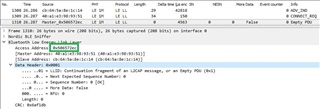

CONNECT_REQ not shown in Python but WireShark
I managed to sniff some communcation in WireShark, ADV_INT, CONNECT_REQ, Empty PDU.
If I try to rebuild the functionality in Python, no CONNECT_REQ ist shown in the packets.

Also extracting the PDU Type from the blePackets Payloads doesn't work out either. Just recently confirmed it's the same as packet.blePacket.advType :-D
It seems that it's never send from the phone (unusal, app and wireshark proves as it's working fine) or it gets lost some how. Restarted the code over and over again so interference or wrong channel can be excluded as an option.
Any idea what i'm doing wrong?

    thats not what i'm trying to accomplish.
    ADV_IND is send out with ACCESS_ADDRESS from my advertising device.
    In the code I'm checking all packages to fit desired Advertising Address, if so, Access Address is stored. (I just learned it's static Packet.ADV_ACCESS_ADDRESS)
    The captured Access Address used to find filter packages.
    If Access Address fitsand PDU_Typ is CONNECT_REQ it's send by central, which tries to connect to the advertisind device.
    That CONNECT_REQ package contains the new ACCESS ADDRESS. (Thats what I'm missing as I newer see one of those packages!!!)
    ACCESS ADDRESS is used to identify packages sent between central and the advertising device
    Any clue what got wrong?

  • Set the sniffer to follow a specific device , if not, you will only get ADV packets and never the connect_req
  • got it, thanks :-)
    # Wait to allow the sniffer to discover device mySniffer.
    time.sleep(5)
    # Retrieve list of discovered devicemySniffer.
    d = mySniffer.getDevices()
    # Find device with name "Example".
    dev = d.find('Example')
