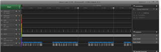

I send 32 bytes of data in 4 milliseconds via UART. Peripheral sends this to ble_app_uart_c for a certain period of time. But after a very short time there is fatal error.
When I increase the time to 5 ms, it can send a lot more packages.
The part of the code I send via the BLE is as follows.

Data from UART is as follows.
What is BLE speed using notifications? Please help me.
